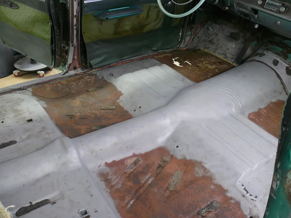

    Post  gasolinejunky Tue Feb 14, 2012 8:06 am
    removing interior to install new floor panels.my other project....a 57 bel air. Floor3

    my other project....a 57 bel air. Empty Re: my other project....a 57 bel air.
    Post  gasolinejunky Tue Feb 14, 2012 8:07 am
    will look better once i sand blast it.my other project....a 57 bel air. Floor4

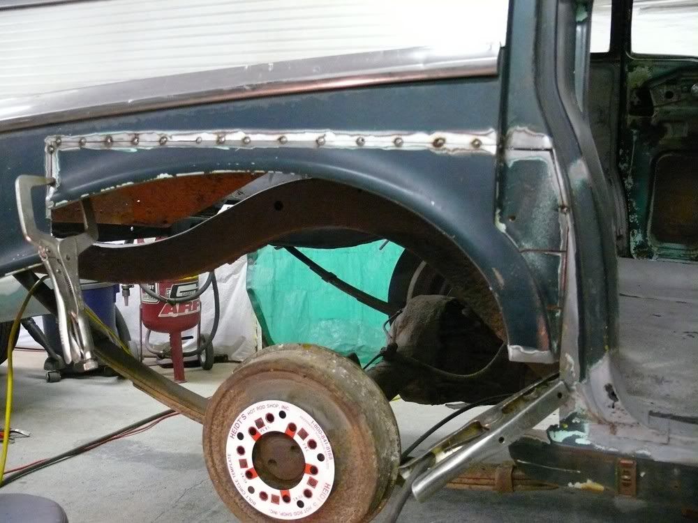

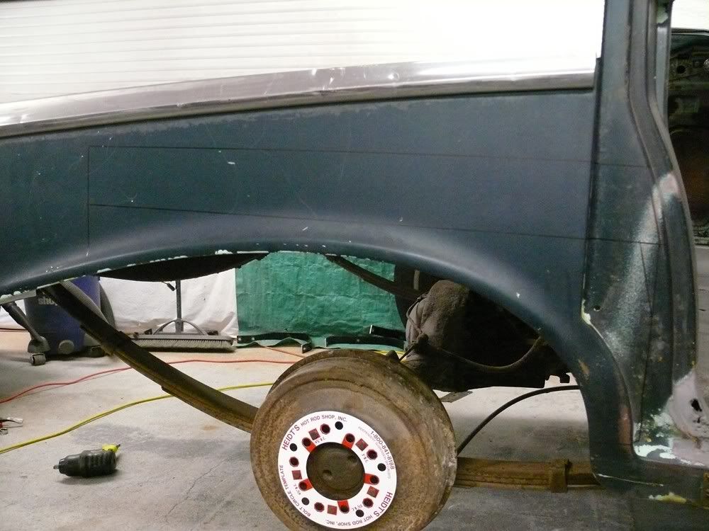

    Post  gasolinejunky Sun Feb 19, 2012 8:14 am
    gona raise the well 3 inches ...on a four door this is a trick.my other project....a 57 bel air. 001-2
    Post  gasolinejunky Sun Feb 19, 2012 8:16 am
    not for the faint of heart...lolmy other project....a 57 bel air. 003-3

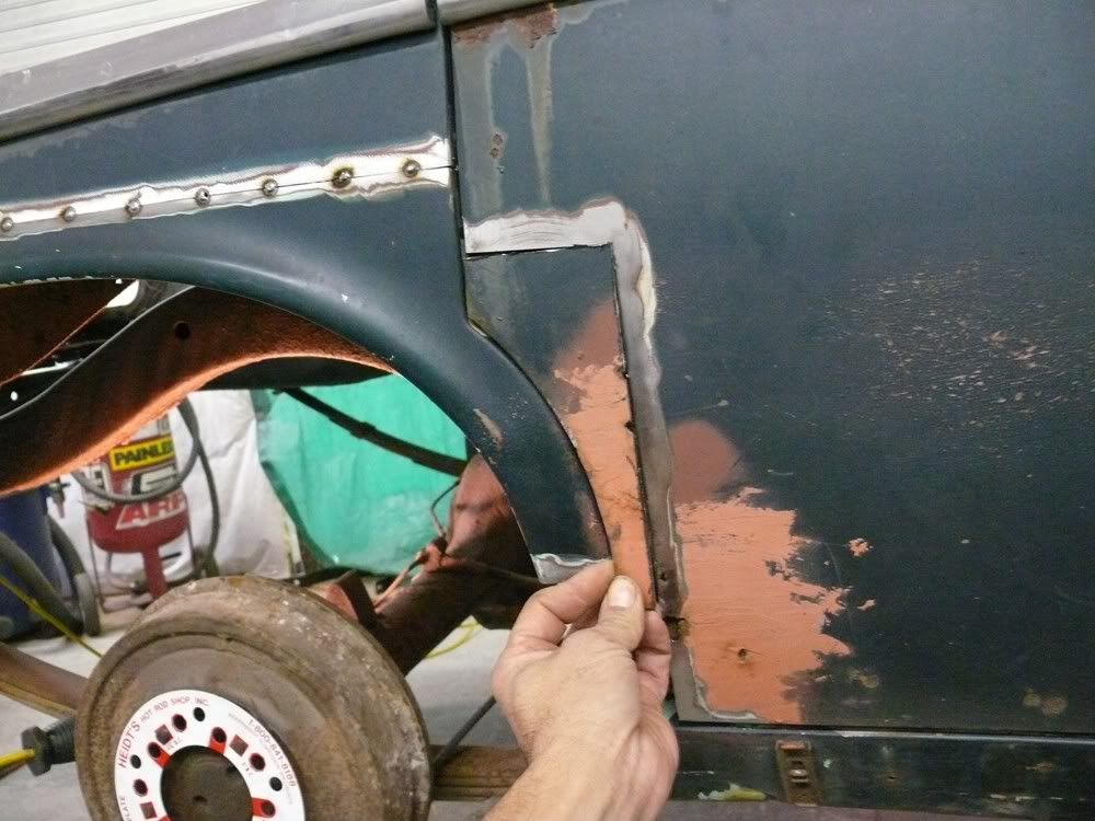

    my other project....a 57 bel air. 009
    Post  gasolinejunky Sun Feb 19, 2012 8:17 am
    my other project....a 57 bel air. 014
    had to stretch door 3 inches.my other project....a 57 bel air. 032

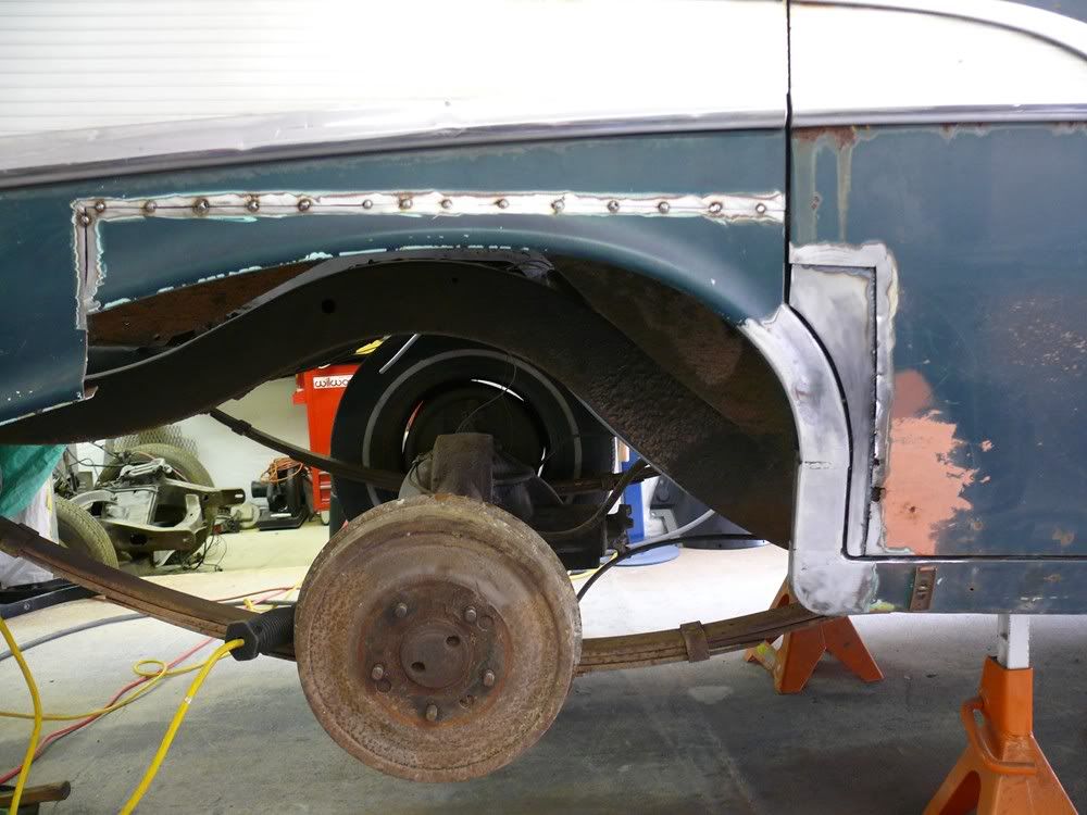

    Post  gasolinejunky Sun Feb 19, 2012 8:19 am
    at the rear i spliced it and brought it up to meet it.my other project....a 57 bel air. 034
