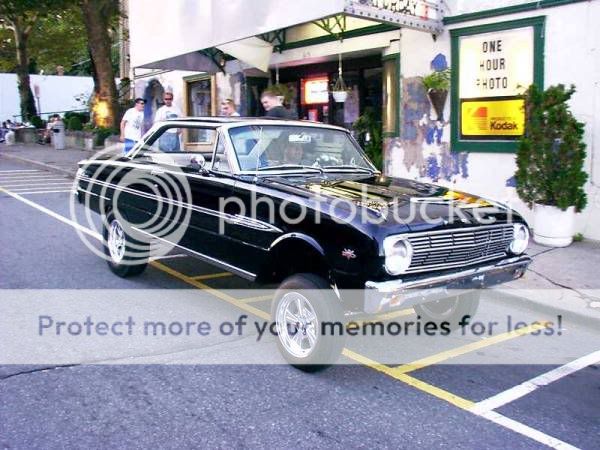

    Local junkyard owner I know is a Falcon fanatic, of which he has a few. If there's parts you can't find I can always ask. BTW, here's a pic of the Falkoon.
    New Car Project 521134-tallfordfalkoon
