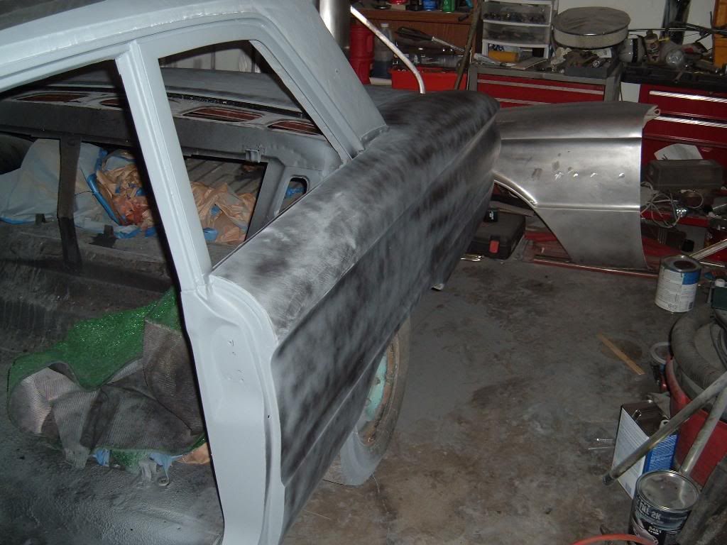

    Scuffed out the etching prime, and masked off the dash. I got it in second prime (the gray high build stuff), and started the block sanding with a guide coat spray. I didn't think the car would be smooth and straight enough to be black, but I was wrong. I found three high spots in the quarter I replaced, and I will be able to get rid of them with primer. I have a little touch up work to do in the way of pin holes, and a couple little low spots. So far, it's gonna be SWEET!!!!. My Gun Metal Gray Metallic should be here tomorrow, or the next day, so I should have this thing ready by then. I am going to finish boarding it out, and will be doing another round of the gray primer so I have a complete uniform, and smooth primed surface for the paint to go on. I am priming the parts individually, but will be putting color on as a whole. I will start with all the jams, and edges around the fenders and such, and then mask the under panels, and loosely assemble it for exterior color. There's more pics in my photobucket, but here are a couple more.
