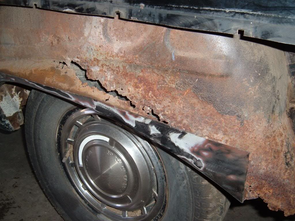

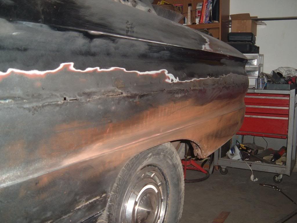

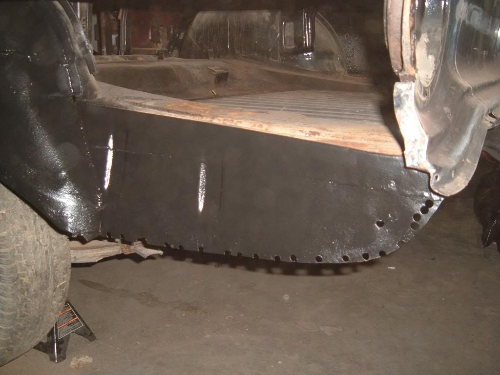

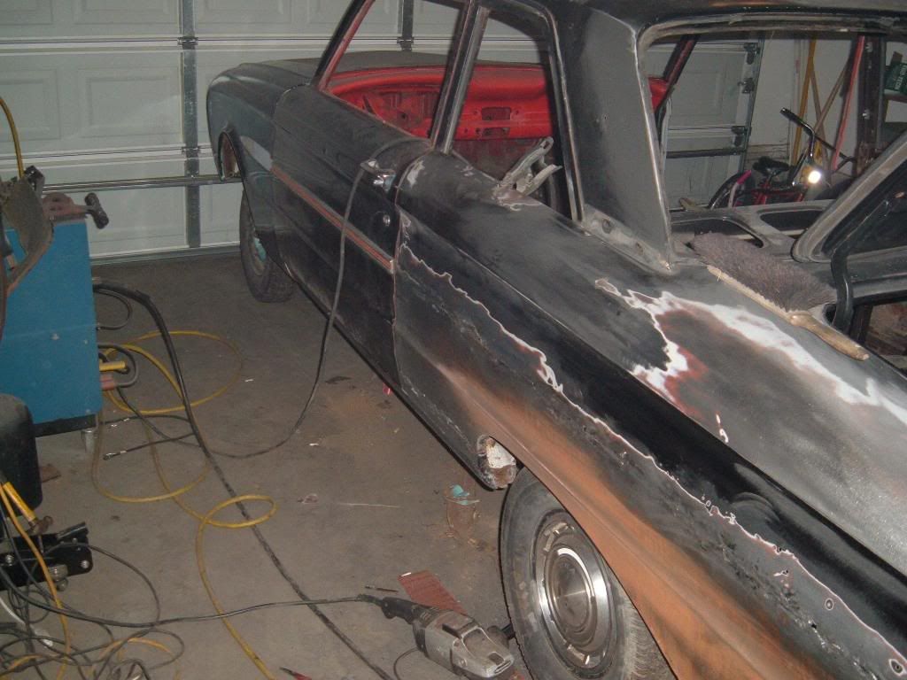

    A bit more was accomplished today. I managed to get the rear inner quarter panel replaced, and ready for the outer Q/P. I'll be working on the outer tomorrow. A few more pictures in my photobucket, but here are the before and afters.

    You seem to be making steady progress. As a matter of fact, if the lack of posting lately is any indication, you are the only one of us who is getting anything done. It's like the rest of the guys have gone into hibernation. Of course I too have not done anything on my trucks. But I have been working on equipment in the shop which will be pressed into service when I get back on the trucks. Considering you are also in the midst of getting another place to live and relocating, you are making great progress. I hoping the rest of us will soon be able to get some posts up on our build threads. I'm counting on the better weather to come and hopefully the resurgence of the economy to make things better.
    Looking at your latest work it makes me wonder if the designers ever considered the possibility of rust occurring in places that were obviously natural rust magnets. I see that they have finally done better in that area in what I see of the later models I look at in the bone yards. I'm sure that the extensive use of galvanized metal helped a lot too.
    Keep up the good work and keep us posted.

    Post  wmjoe1953 Sun Jan 24, 2010 12:02 pm
    I think they did put some thought into rust. The area I'm repairing does have a drain hole. The rust in this one was caused by mice. The little buggers get in there, make their nests, and after so long of them using their beds as toilets, it creates a very corrosive mess that sits and collects moisture, and eats at the metal. This was the only spot in the car with any rust damage. Now, in most cases, it's the collection of water in these areas, due to leaking gaskets, and such. The drain holes were rarely big enough, and got easily plugged up, and usually weren't low enough in the panel they planned on draining.

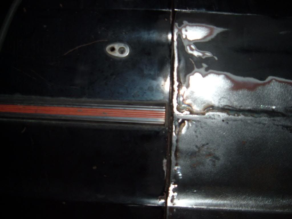

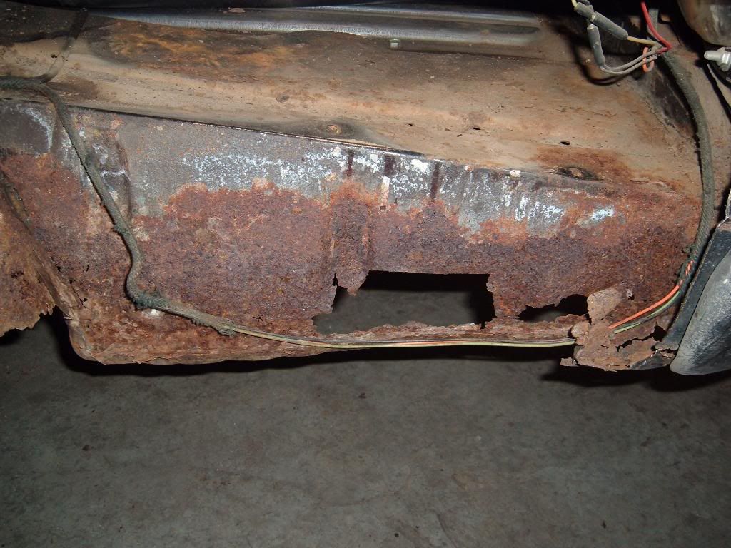

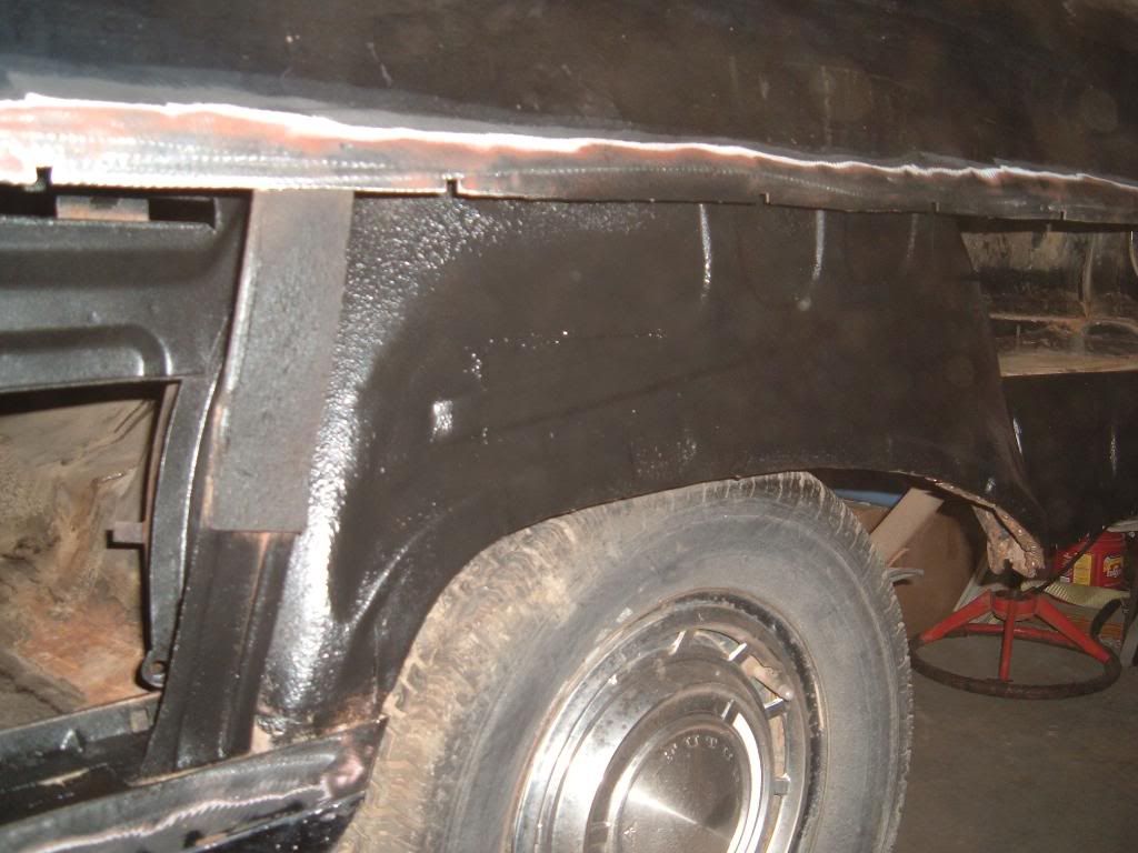

    Post  wmjoe1953 Sun Jan 31, 2010 1:53 am
    And still a little more progress. I'll be picking up a '63 4 speed steering column in a week or two, along with the T-5 tranny, and it's mating '93 Mustang Cobra engine. I'm also going to get a straight rear bumper, since mine is all beat up. I have been working on stitching in the rear quarter panel. It's more or less in, and I am now in the welding it up, smoothing it out stage. I'm getting a new body hammer, and dolly set on Wednesday, so that will really help out in the smoothing out the little dings, and dents areas. Especially around the quarter I've been welding in. Matching up a used quarter on an old car is a PAIN in the ARS. No two cars are absolutelt identical, so there are plenty of little fitment issues to overcome. Oh well, it will all be worth the extra effort when done. So far, I think that by the time I'm done with this quarter panel, and get it all worked over with the hammers, and dollies, it really won't need much in the way of fillers. Anyhow, 16 pictures added to the photo bucket, and here's a couple of them. You can really see the mess in the second picture. This is from trying to get the two panels to line up with eacthother, and line up with the door at the same time. I actually had to grind off the front edge of the quarter, and am rebuilding it. One panel had too much metal from the factory, and the other was tucked in real tight originally. Oh well, it's the name of the game.

    Post  Darkside Dave Sun Jan 31, 2010 11:11 am
    Looking good there Joe...
    Those long flat surfaces can be a real pain to put together and get smoothed out, but I think you will get there. Actually your progress has been quite rapid compared to most people doing this as a hobby as opposed to being a regular job. I hope to get back on my own project and get some stuff posted but there are other things that are impeding my progress. Maybe by late March or early April.
    Right now you are our build thread posting champion. Thanks for posting and keep up the good work.
