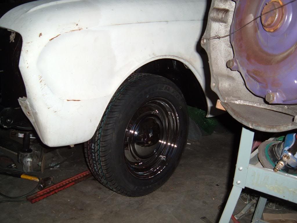

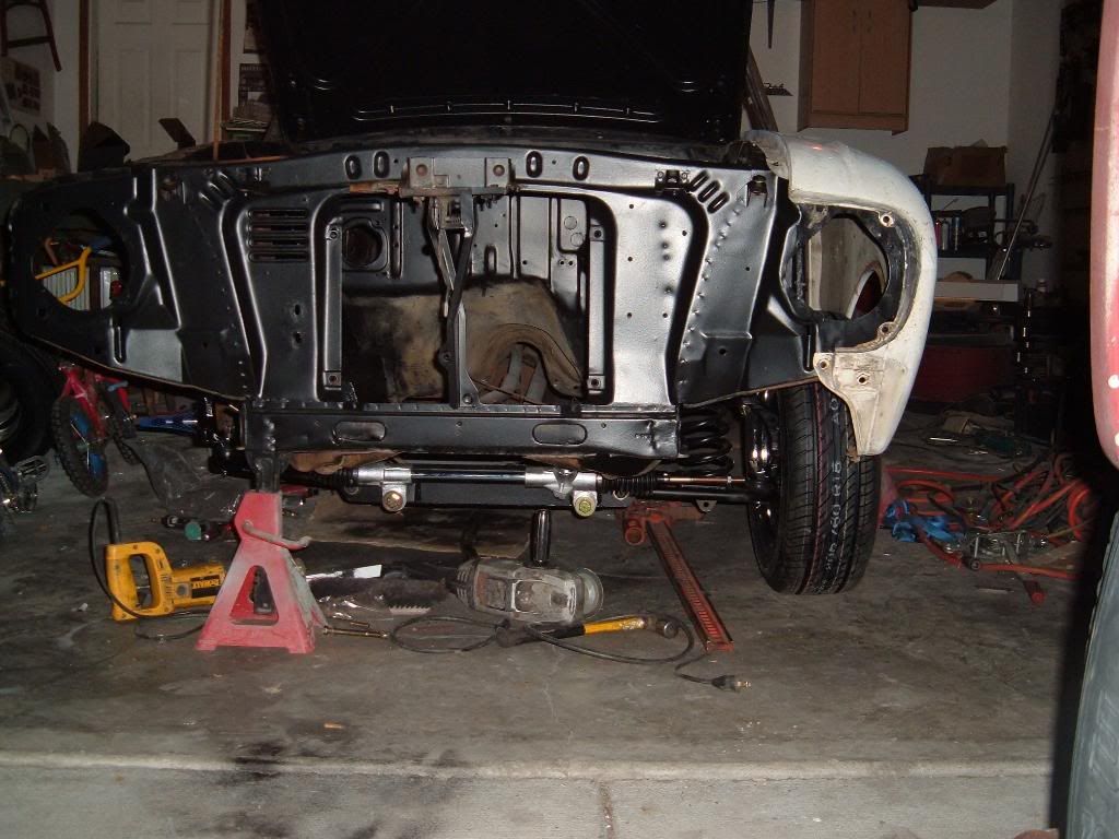

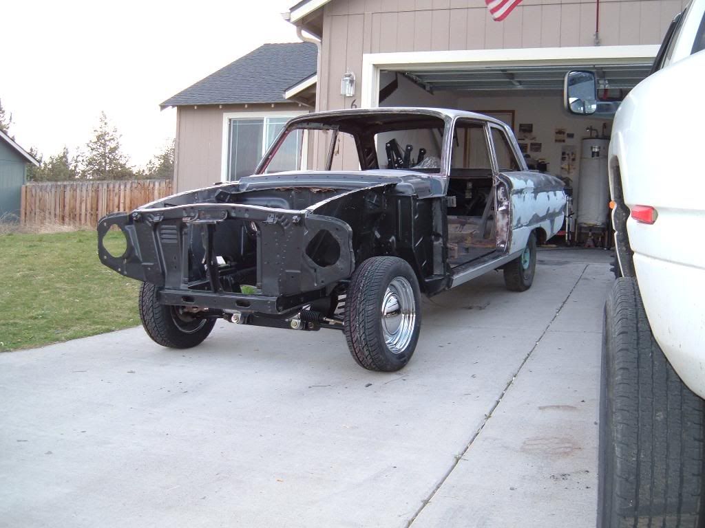

    Post  wmjoe1953 Wed Apr 14, 2010 2:24 am
    Got the MII front end under it. I picked up some 15x6 chrome smoothies, with baby moons too. More photos in my photobucket, but here are a couple for ya. I got a lot of the body work done, but still need to finish it up. It's almost ready for paint, which will be perfect timing, since the weather is starting to get warmer. The after install ride height is about 3-4" lower than stock in the front end. Since the Falcons always seemed high in the front, I think it will be perfect. I picked up several more parts for it, so I should be able to start making major head way again. There's more photos, so check em out.

    And a nice shot of the new 15" wheel, and moon cap
    1963 Futura Build-up - Page 3 DSCF1793

    Post  Darkside Dave Wed Apr 14, 2010 9:04 am
    Hi Joe,
    I see you have really been progressing. You and Stephen67 with his truck are the only two guys that seem to be getting stuff done. I keep getting tied up in doing other people's stuff but that is what pays so I keep doing it.

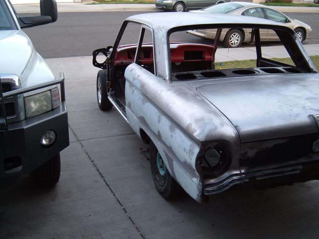

    Post  wmjoe1953 Tue May 04, 2010 11:18 pm
    A couple more pictures were added to my photobucket, but they are mostly redundant, and not worth adding to the thread. I've just about finsihed stripping the front fenders, and did get the rear panel stripped. We've had a few really cold weekends, so it's been difficult getting much done. I got the ding in the roof handled, and the seams at the rear roof pillar. I got all my interior taken care of. I ordered a carpet, door panels, and seat upholestry from Lonestar on ebay. They are REALLY REALLY nice parts. I'll spread em out and take pictures this weekend, and post em up. I got some self etching primer, and primer surfacer ordered, and will be able to prime it next weekend (not this one coming up, but the following). I have just about everything for it now, except weather stripping. I think I am changing my paint color choice. I found a nice gun metal grey metallic I think I am going to go with instead, with the red interior. After I get it assembled, I will be putting it on ebay, with a $7500-$8000 opening bid. I think it should be worth at least that much. NADA has "high retail" at $7500 approx. My headliner will be here this week or early next week. I have new (restored/rechromed) bumpers front and rear.

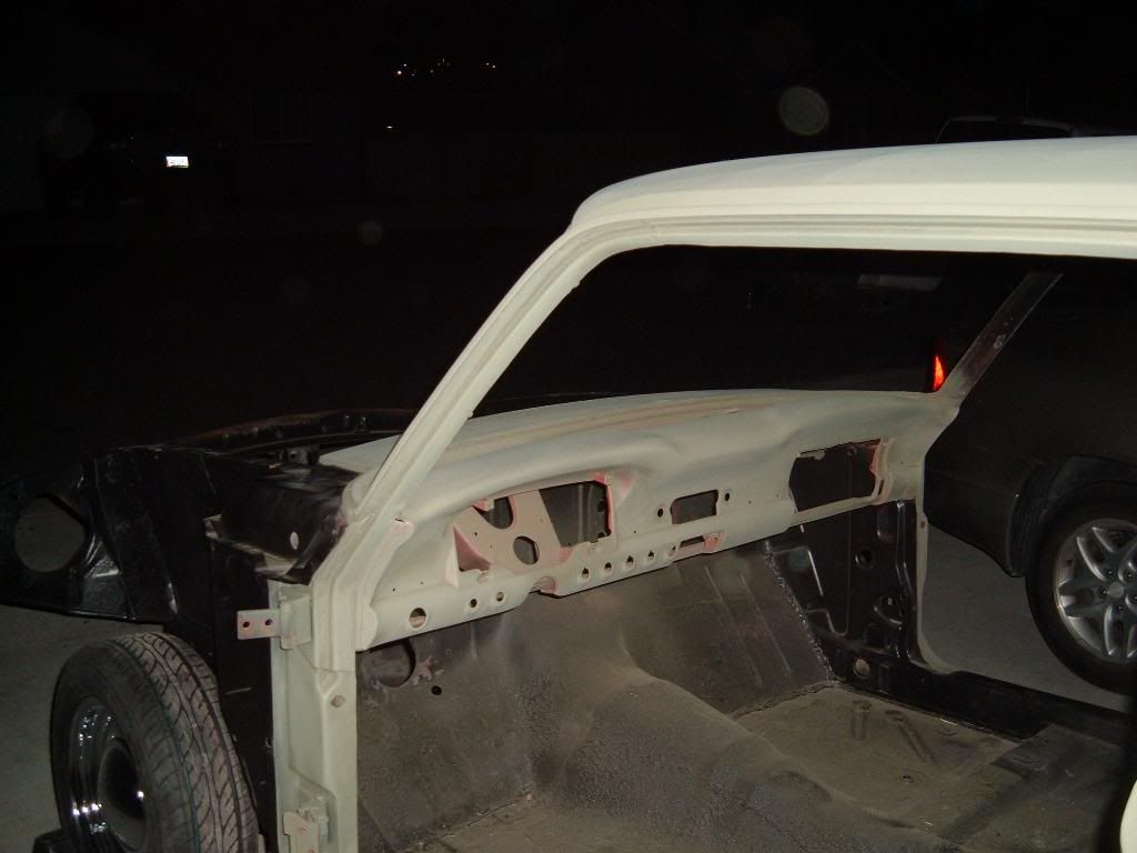

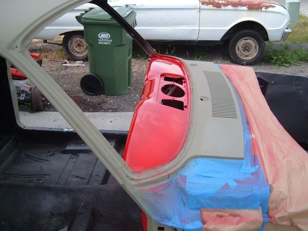

    Post  wmjoe1953 Fri May 14, 2010 1:11 am

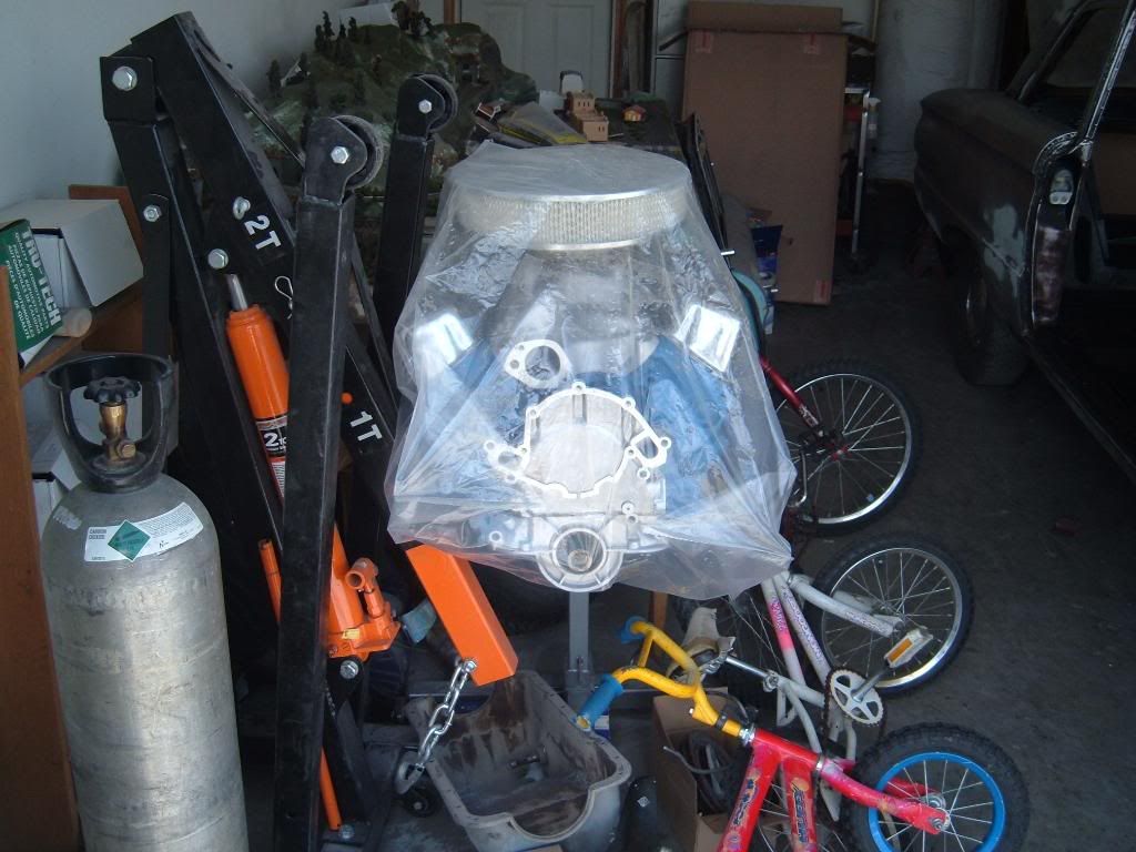

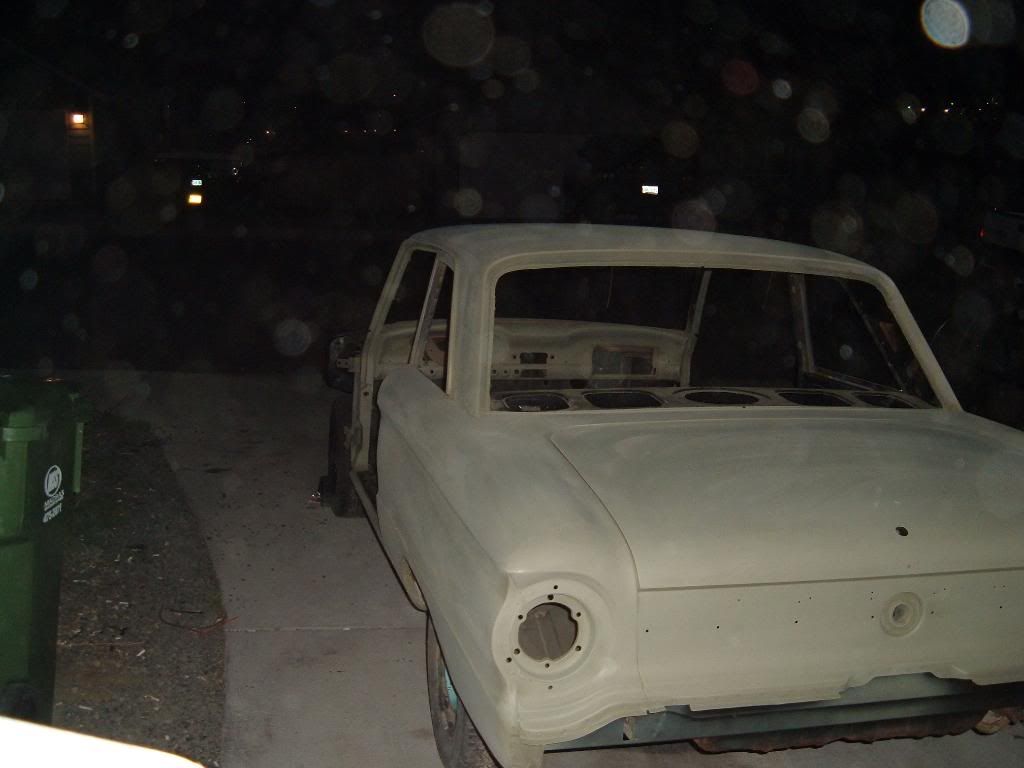

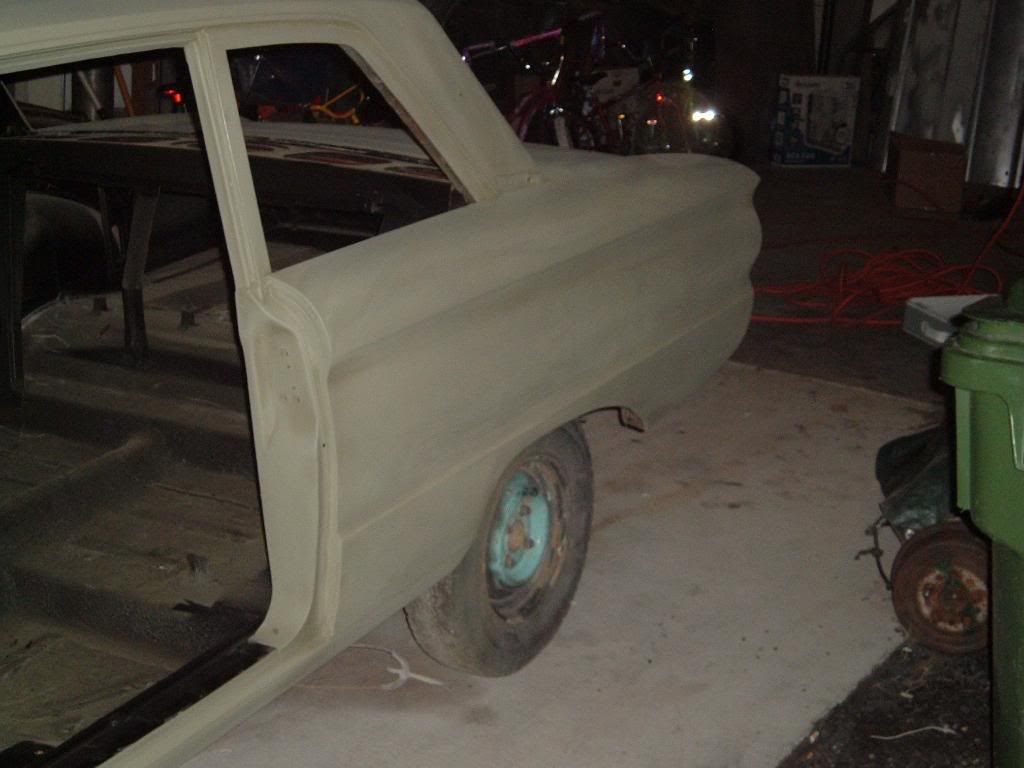

    I got my primers and their respective activators/reducers. I got the car all prepped for the shell to go into etch. I sprayed the etching primer today after work. I got really great coverage, concidering it only takes a thin coating of the etch, with about 1.5 qts of material. Bear in mind, this is just the shell, no doors, and no hood, or front fenders. I have more pictures in my photobucket, but here are a couple. Over the last weekend, I managed to finiah up the long block, and am ready to button up the engine with the intake and such. I still haven't swapped the rear end out yet, but I might get to it this weekend. I will be able to get the entire project in final primer this weekend, and may even be able to get the interior parts that will be red, in color. I am hoping that the Gun Metal Grey Metallic will show up tomorrow, but if not, it should be here Monday, and I'll be able to shoot the outside next week. It's starting to come together more rapidly now, and after the etch went on, I noticed only a few minor flaws that need to be addressed. So, all in all, it is a really straight looking car, and should turn out REALLY SUPER nice. Will keep you posted.
    The Engine:

    Before Prime:
    1963 Futura Build-up - Page 3 DSCF1809
    After Prime:
    1963 Futura Build-up - Page 3 DSCF1844
    1963 Futura Build-up - Page 3 DSCF1842
    1963 Futura Build-up - Page 3 DSCF1841

    Post  Darkside Dave Fri May 14, 2010 9:46 am
    Man you are going way too fast... You better watch out for 55F350, aka Kevin... When someone gets to going fast on a project he gets out his voodoo effigies and stars drilling holes in them with a Chinese harbor Freight drill so it will put a curse on your project. I know this because he admits it. He screwed up my plasma cutter because he said I was making too much progress. But that's OK, I now have plump little mail man doll and I'm not afraid to use it.
    Oh. BTW, nice work Man...

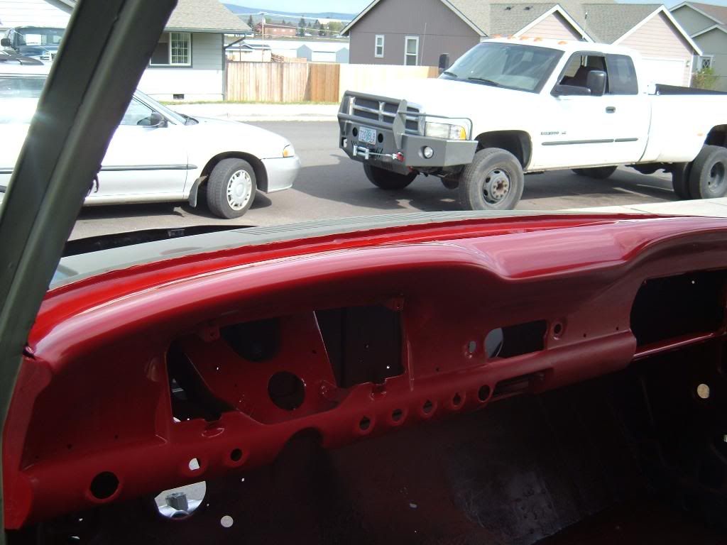

    Painted the dash board today. It's a real nice, shiney red now. After several hours, I was able to wet sand it with 2000 grit, and started buffing it. I got the top of it buffed, for the most part. I need to go buy me a buffer, cause this by hand shit has gotta go. There's NO way I'll be able to cut and buff the entire car by hand.
    1963 Futura Build-up - Page 3 DSCF1850

    Post  Darkside Dave Sat May 15, 2010 9:35 pm
    Nice lookin' dash Man...
    I know how that hand buffing thing goes...
