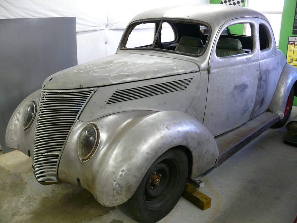

    I bought this car off the internet last February,some one had already had a Heidts super ride 2 with polished a arms installed,a currie 9 inch 373 posi,four wheel disc,polish wilwood calipers,frame boxed.etc then let it sit outside for 2 years,i have sinced sand blasted it,cleaned up all the parts.cut out a poorly installed bitchin firewall and replaced it with an original 40 firewall,they tried to channel it and butchered the foot pads at the pillars,what a mess it was,lol.Im gona build a 50's hot rod.1937 ford coupe 37body3

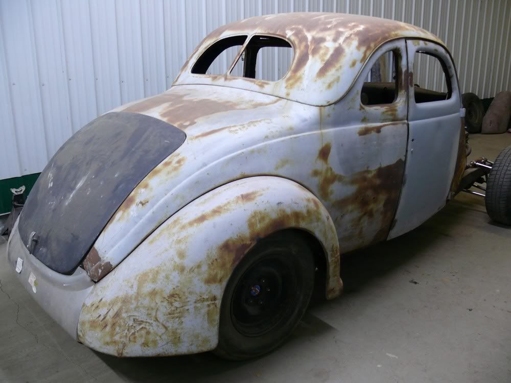

    this is what it looked like when i bought it.i tossed the 94 vette LT1 for a ford 351w,lol ford in a ford,and yes i am a chevy guy but i dont believe they go in Fords.1937 ford coupe 37064

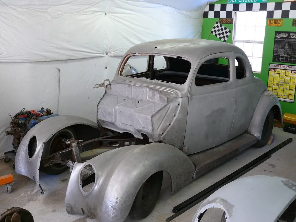

    i split the firewall 9 inches for clearance,4.5 inches on both sides.1937 ford coupe Firewallsplit

    rear shot when i went to buy her.1937 ford coupe 37rrside

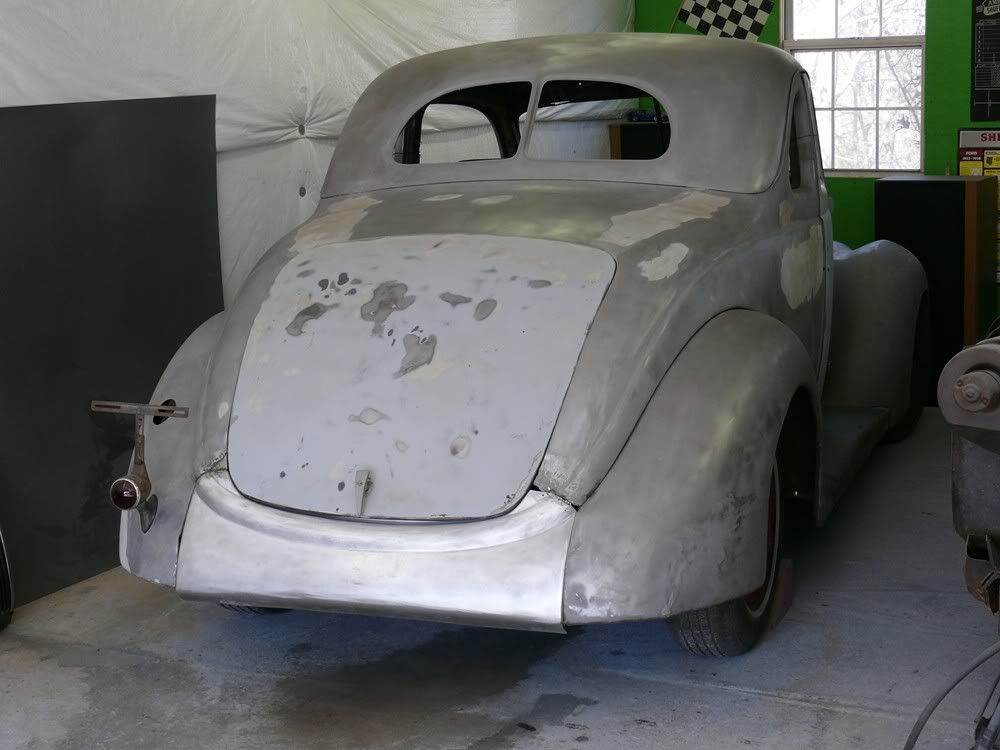

    rear shot after blasting 1937 ford coupe Hinesite

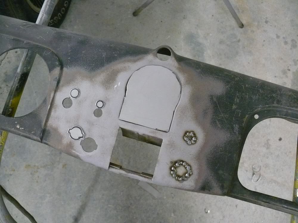

    1937 ford coupe 003 filling in dash to paint and install new gauges.
    1937 ford coupe Empty Re: 1937 ford coupe
    Post  Darkside Dave Thu Jan 19, 2012 10:47 am
    It appears that the dash was not welded into the body which makes it a lot easier to work on. The dash's in my thrucks ara an itnregal and welded in part of the body, two of which I have cut out with a plasma cutter to replace them with complete modern dash's for late model vehicles. Which is not something I would do with a car like you have. Looks like you are doing great work and making good progress.

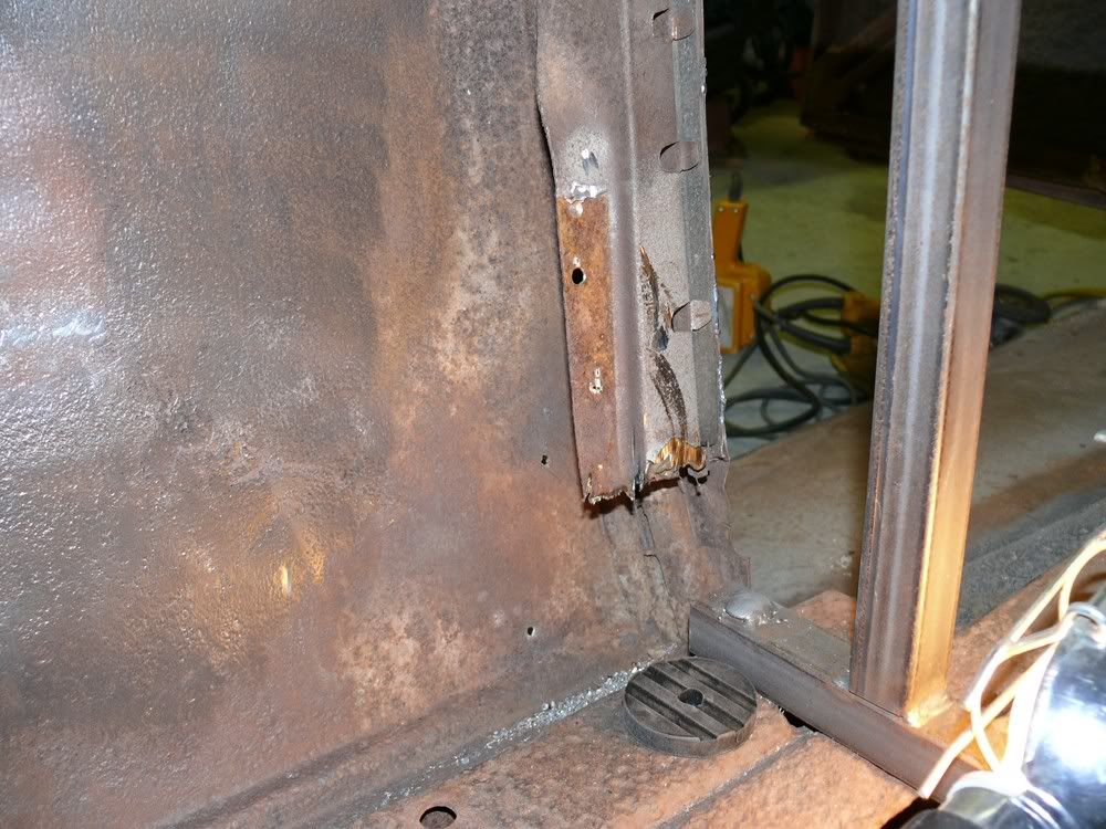

    hey Dave,this is the b pillar where door closes,i have to rebuild and replace the foot pad mount,the last guy hacked it off in a poor attemp to channel the body.I dont suppose i can get you to take a close up of it on your 37? maybe from a couple angles and one with a tape measure running at an upward position so i can count the distance.thanks a bunch,email em to mikejanet97@att.net 1937 ford coupe Ftpad3
    Post  Darkside Dave Sat Jan 21, 2012 10:49 am
    Hey Man,
    If I had one I'd be glad to do it. The other '37 on here is not mine. Look at his build thread in this category to find his username and send him a PM or e-mail.
    I'm the guy working on the '53 F-100. Of course if you look at my build thread you will see that I have had to deal with a lot of issues worse than this. Dennis Carpenter in NC has a lot of body pieces for these old Fords. You might ne able to get some help there too.
