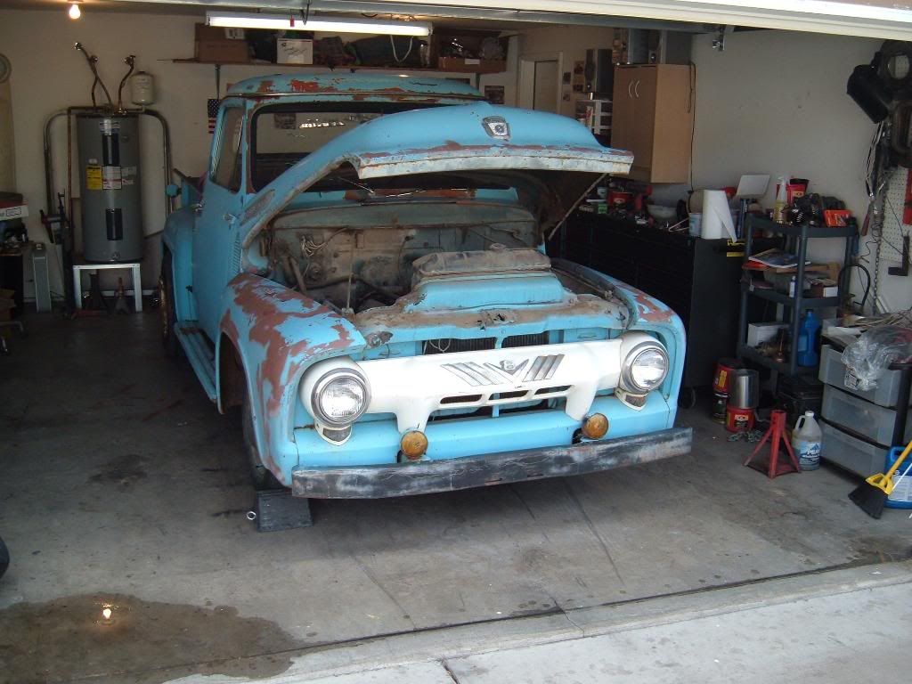

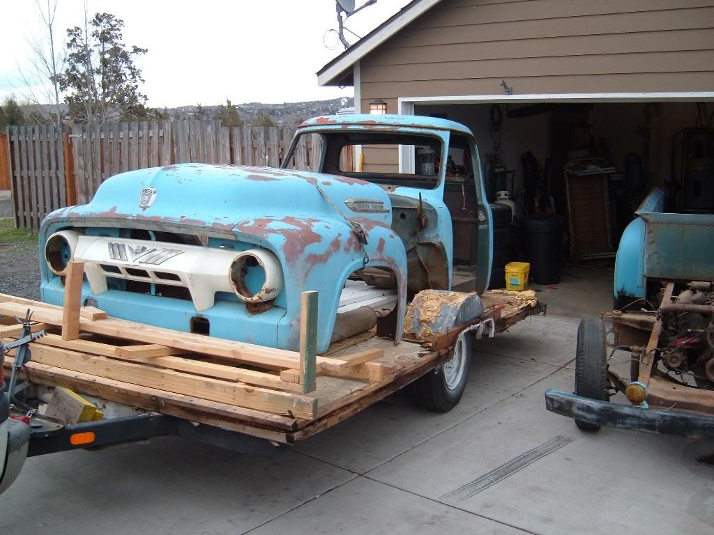

    It's here. Unloaded yesterday. It's a beautiful old truck. This post will get updated often, and I will add a photobucket link to my signature soon.
    1954 F-100 Restoration DSCF2358
    1954 F-100 Restoration DSCF2377
    1954 F-100 Restoration DSCF2362
    1954 F-100 Restoration DSCF2369
    1954 F-100 Restoration DSCF2382

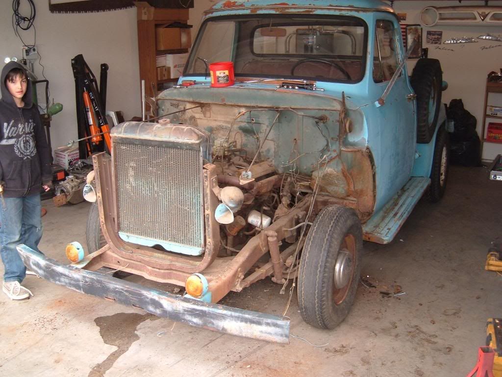

    Post  wmjoe1953 Wed Mar 16, 2011 11:34 pm

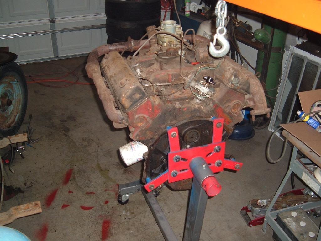

    Engine's out, and on the stand. Transmission's out, and on the floor. Clutch looks original, not cooked, broken, whatever, but used down to the rivets. Popped the valve covers, and the top looks good for its age.
    1954 F-100 Restoration DSCF2462
    1954 F-100 Restoration DSCF2464
    1954 F-100 Restoration DSCF2463
    1954 F-100 Restoration Empty Re: 1954 F-100 Restoration
    Post  Darkside Dave Thu Mar 17, 2011 9:33 am
    Ah yes... The old Y-Block... Back in the days when they couldn't remember to put the damn distributor on the front end of the engine. In spite of my being a Ford guy I really think the Y-block left a lot to be desired. Thank goodness the FE was soon to come. Although it lacked the power, the flathead was a better and more reliable engine. The Y-Blocks were notorious for not providing enough lubrication to the rocker arm shafts. there was even an aftermarket kit to run an external oil line to them to fix the problem. Hopefully, since you are doing a restoration as opposed to a resto-mod, the guy won't be using it as everyday driver. if so I think he would be dissapointed. Like you say, it would make a great museum piece or a trailer queen. People who weren't brought up with these things and were used to all thier little short comings, are oftem dissapointed. they just don't have the mindset to contemplate the way these things handled and what it took to stop them. I have a friend here that has at least five or six restored '56s and he does not like to do the every day driver thing with any of them. Hew will be the first to tell you that they just aren't cut out for todays roads and the way the rest of the world drives. He lives about ten miles out of town and that is as far as he goes with them and then only to a car show or cruise-in. The rest of the time they get trailered. All that being said, I still think it's great that some that are good enough are getting restored. I would never resto-mod anything that was in really great shape. However, since I don't have any desire to own a trailer queen or museum piece, I would probably either do one up for someone else or sell it to someone who was going to do a restore. That's why I'm Darkside Dave I guess. I love the old styles and looks but I want today's comfort, convenience and performance. I intend to do the every day driver thing. Keep up the good work and your pace is so far amazing.

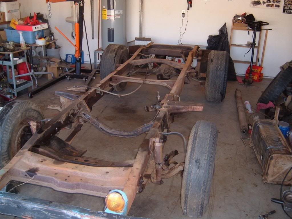

    Well, the truck is completely stripped, and the frame has been scraped, and brushed, and is ready for some rust kill stuff, and paint. I spent the weekend ordering chassis, suspension, and drivetrain parts. The engine should be done this week, and all the goodies should be here over the next several days. The cam bearings were the hardest thing to find, since apparently, the 54 is a one year only fit. Beyond that, the owner has decided, that he wants it as concours as possible, right down to all the correct mirrors, and trimmings, and paint, and everything else. He even wants the correct tags and stickers on the engine parts, like the starter and generator. Will get some more pics soon, I hope.

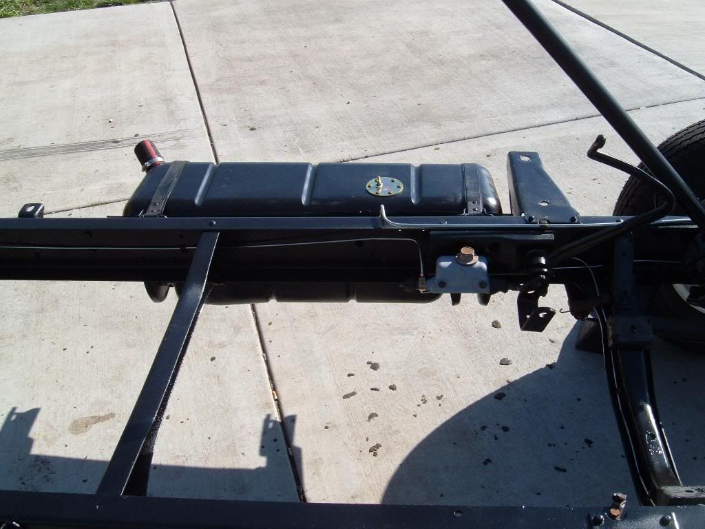

    Post  wmjoe1953 Tue Apr 19, 2011 7:35 pm

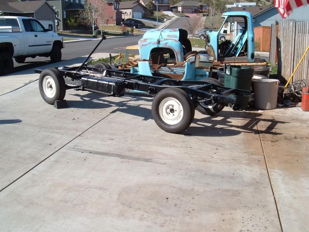

    It's update time. Been BUSY, busy. It's pretty much ready for an engine....yeah!!!
    1954 F-100 Restoration DSCF2683
    1954 F-100 Restoration DSCF2686
    1954 F-100 Restoration DSCF2692

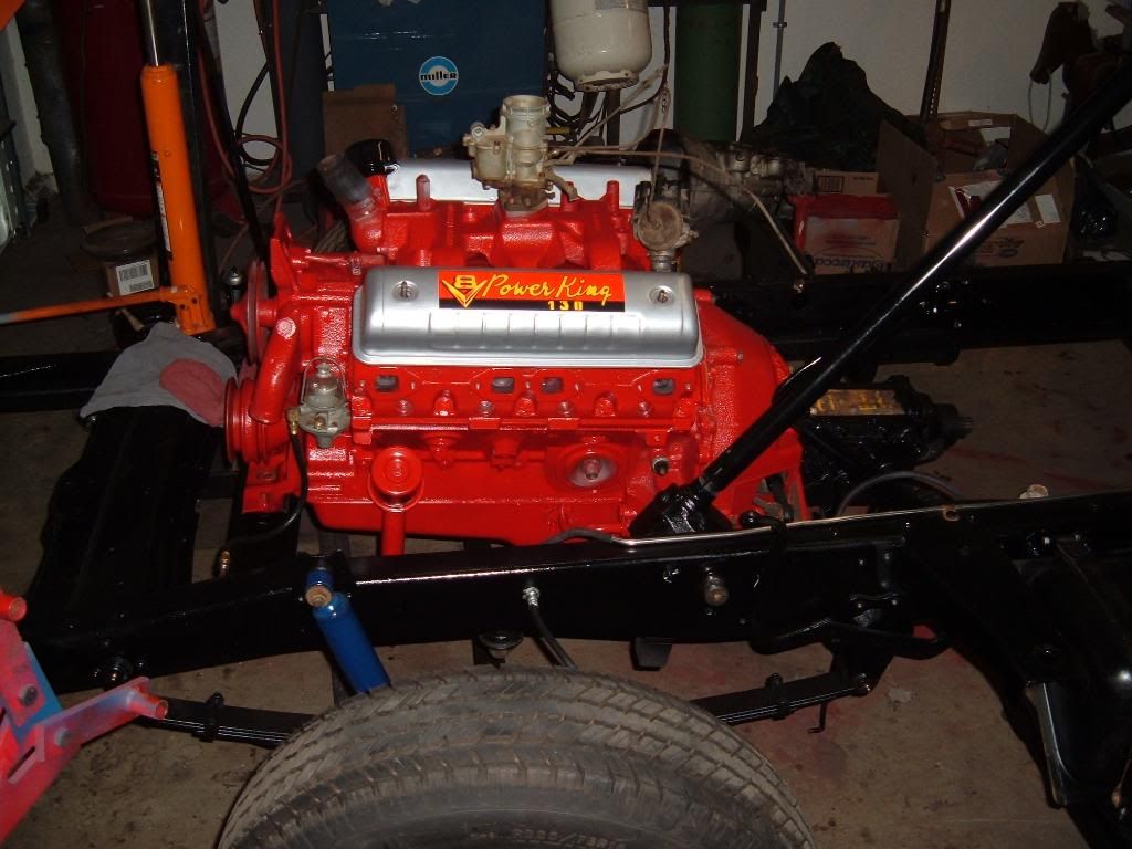

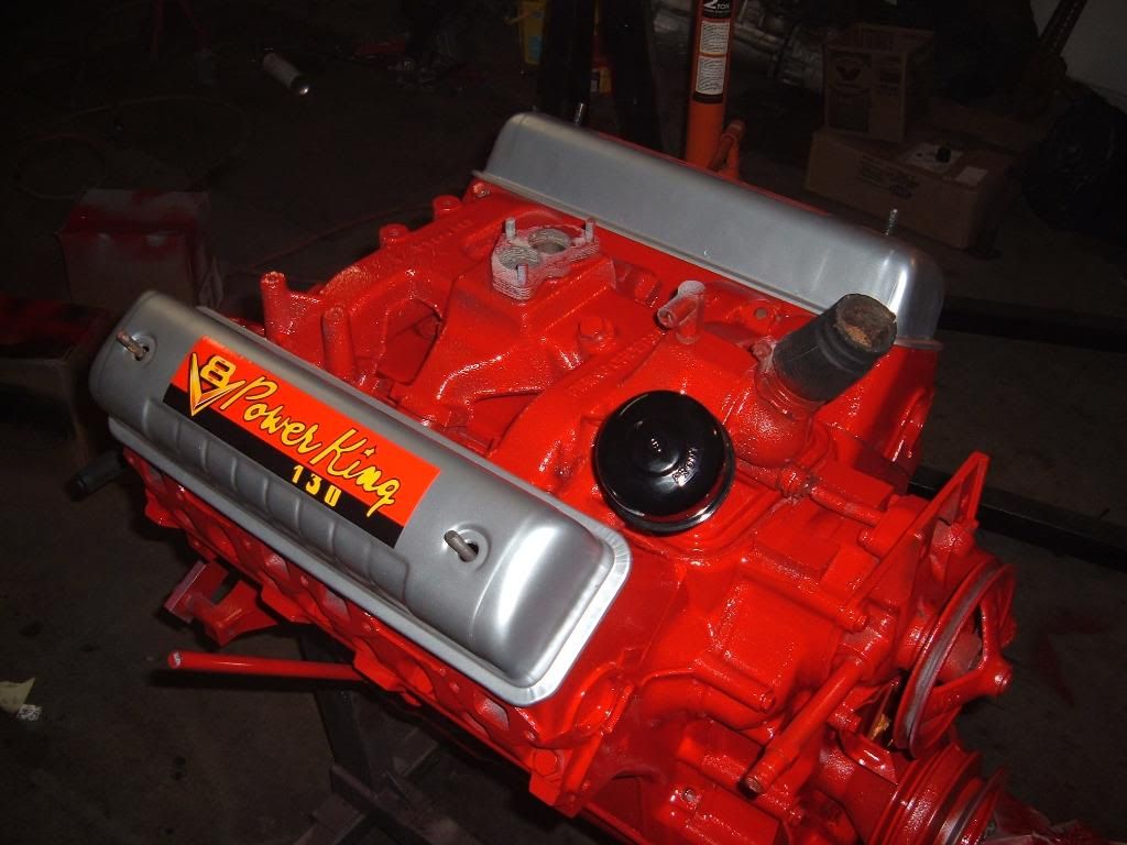

    Post  wmjoe1953 Fri Apr 22, 2011 11:00 am
    And now, I have an engine about ready to go in..
    1954 F-100 Restoration DSCF2725
    1954 F-100 Restoration DSCF2722
    Age : 46
    Post  wmjoe1953 Fri Apr 22, 2011 11:01 am
    I need to change the thermostat, and clean up that heater hose fitting, and change out the motor mount, and then install the distibutor, and I can set the motor. I can actually put it in first, and do all those, but I don't know, either way.

    Post  wmjoe1953 Sat Apr 23, 2011 2:06 am
    And this is todays progress. The distributor is just sitting in there, and the carb is just resting on the intake. I still need to rebuild the carb, and clean up the distributor.

    Post  DL BOGART Sun Apr 24, 2011 6:32 pm
    Looks great so far, but I wonder how that tiny transmission will handle the torque of that 292. I've been around a few that were plenty stout.
    Age : 46
    Post  wmjoe1953 Sun Apr 24, 2011 8:59 pm
    DL BOGART wrote:Looks great so far, but I wonder how that tiny transmission will handle the torque of that 292. I've been around a few that were plenty stout.
    I'm a fraid, that it's not a 292. It's 239.4 cubic inches of 1954 Ford Y-block power. It is the original motor, and was rebuilt without having to overbore, or grind the cranck, so it is still a 239. Actually, these little 3 speed trannies are pretty stout. When I opened it up, the gears are all very heavy steel, and looked to be in excellent condition.
