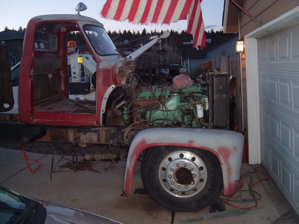

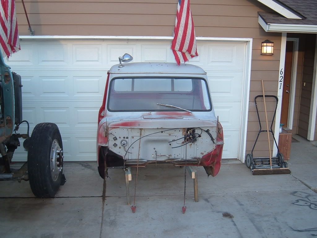

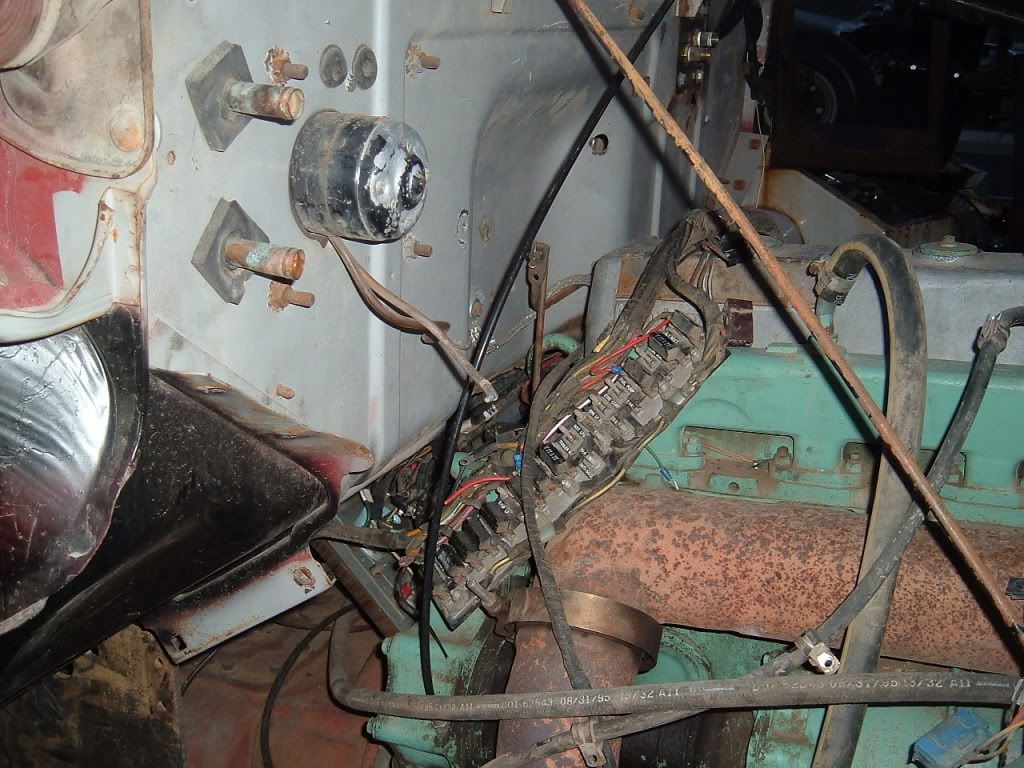

    Hey darksiders!!!!! Figured I should update my build page on here, since I finally managed to get some time in on the build. Busy, busy summer finally slowed down a bit, and I've been plugging away at the Big Job. I've had to completely rebuild the floor, toe-board, firewall, and cowl on the beast, just to house that monsterous 6-71 Detroit Diesel engine. I also have to build a nose for it. So, I worked the cab, and the cowl area over, built the frame work for the running boards, and started a rough in of the hood. Still tons of work to do for the hood, but I can get it over the winter. The truck is currently at a point where I had to stop cutting, and welding, and start assembling a few things inorder to finish my cutting, and welding. I got a chance to fire it back up, and man oh man, that 6-71 Detroit sounds damned good. While I ran it, I jumped the Jake Brake wires, and was able to crack the throttle, and let the jake come on. Oh, I forgot, I did this with out a muffler/exhaust system. Man, an uncorked Jake is LOUD!!!!!!!!. Anyhow, here:
