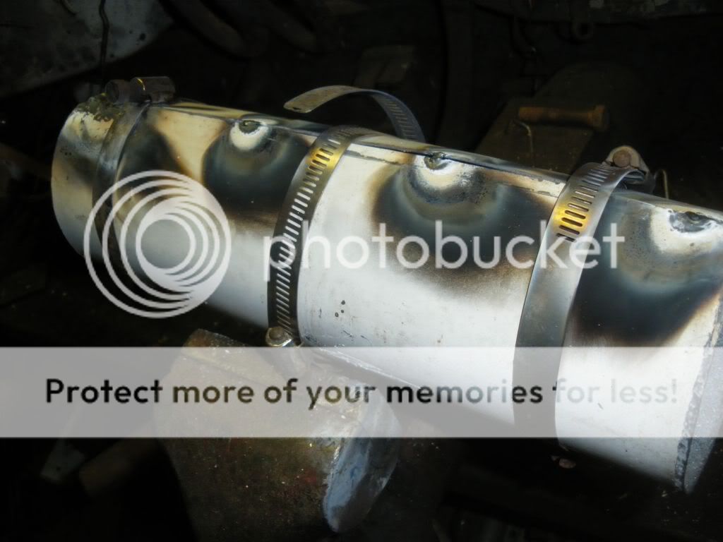

    When I was a kid I really liked the step by step photos in hotrod magazines
    so heres step by step photos of my tailight installation.
    This is the way I do it and if you know a better way, I sure would like to learn it!
    I take a flat piece of metal 11 1/2" by 11 1/2" because I want to make a 3 1/2" diameter tube.
    I run it thru the English Wheel to make it curl up, then use hose clamps to hold it while I weld it.
    I have seen guys obsessing about where to get metal to work on their cars. This metal was the skin of a washing machine...or maybe a dryer. Good stuff.
    I keep car and truck hoods and cut them up as needed, too.
    Heres the tube
